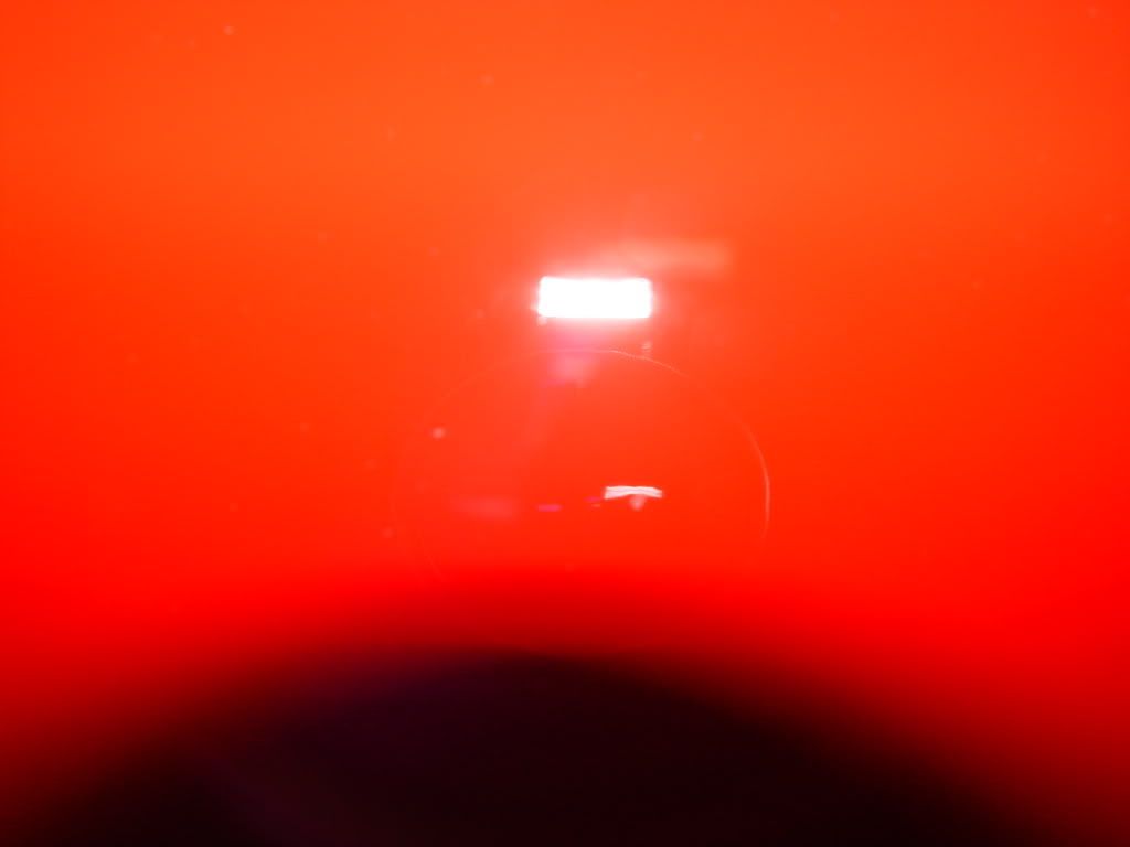

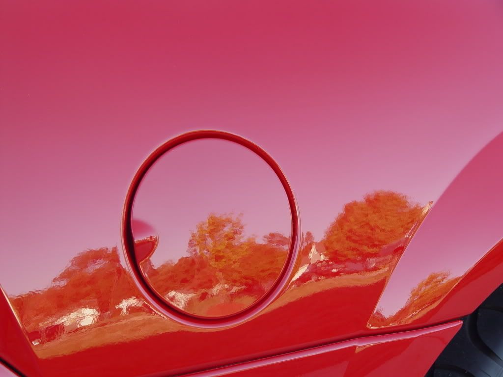

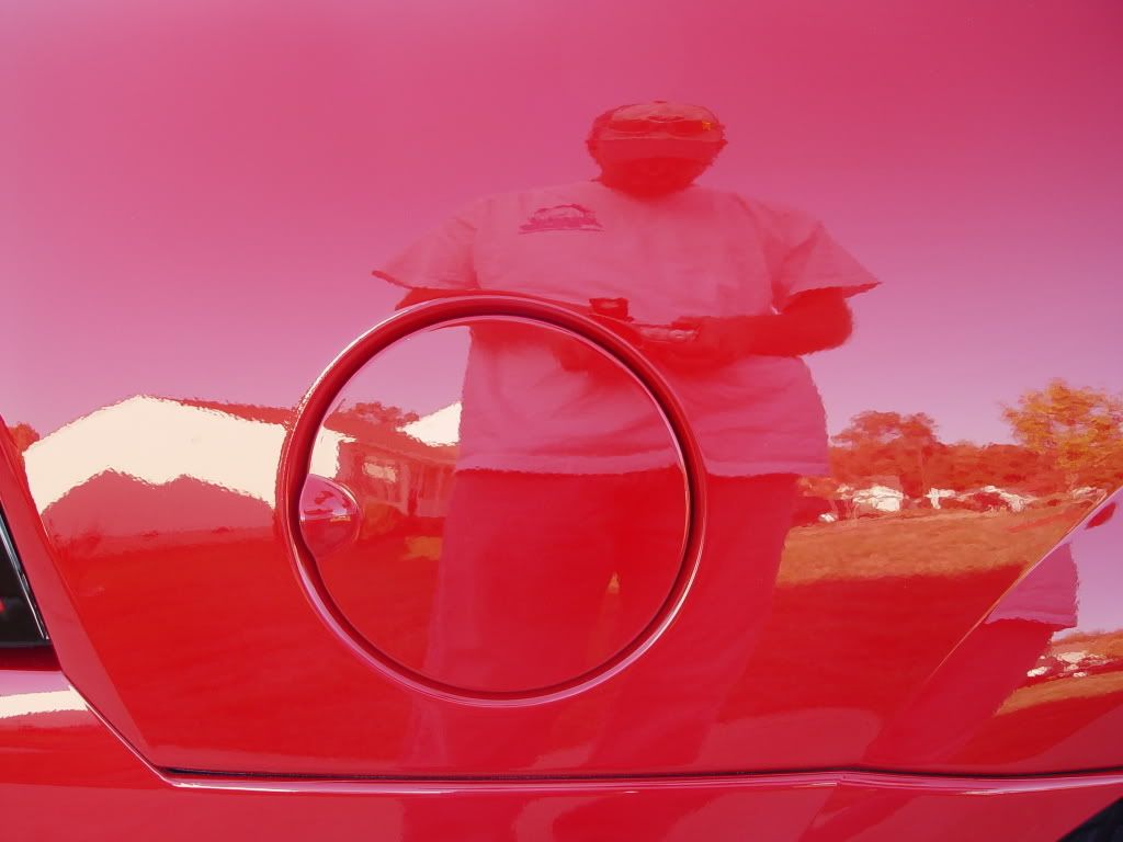

Here is what I did today and yesterday. I applied the SSR1 with white pad and didn't change any. So I stayed with the SSR2.5 with orange pad and finish was the best I could get it. here is what I have so far with 3 coats of EX-p, tomorrow I will put on 5 coats of the nattys
